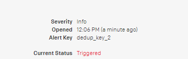

2.) I’m checking, the alert was created:
3.) I’m checking the alert key:
Pg_1_triggered_alert_key

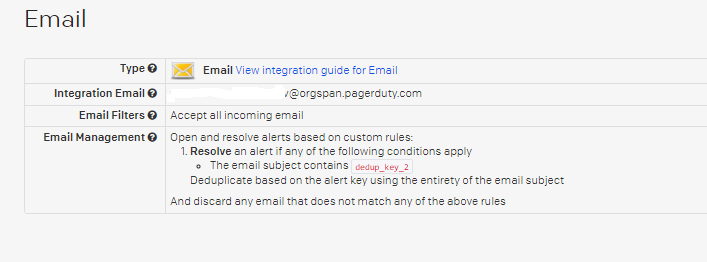

4.) I’m setting the email integration:

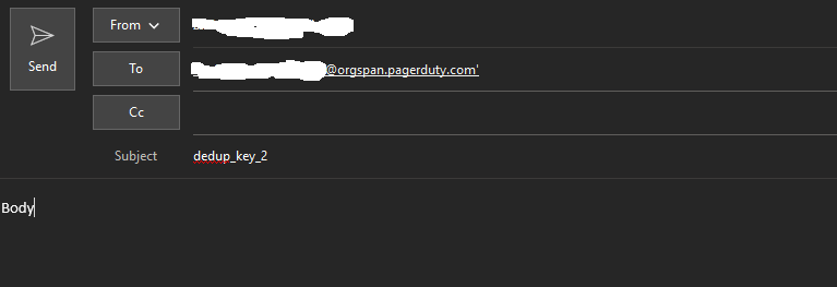

5.) I’m sending an email to the “intergation email” with the alert key.

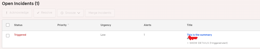

6.) The triggered alert is not resolved this way.
The “intergation email” address is working, I checked.

Thank you for the explanation.
We aren’t able to support this an incident would need to be triggered and resolved in the same manner, e.g. trigger email and resolve email. However I have shared this use case internally within the team and let them know what you are looking for.
